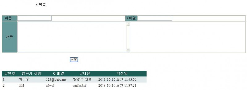

ASP.Net 방명록 작성

방명록

<asp:Button ID="btnSave" runat="server" Text="저장" onclick="btnSave_Click" />
<br />
<br />
<asp:ValidationSummary ID="ValidationSummary1" runat="server"
ShowMessageBox="True" ShowSummary="False" />
<br />
<asp:GridView ID="VisitorGrid" runat="server" AutoGenerateColumns="False"
CellPadding="4" ForeColor="#333333" GridLines="None" Width="656px"
onpageindexchanging="VisitorGrid_PageIndexChanging">
<AlternatingRowStyle BackColor="White" />
<EditRowStyle BackColor="#7C6F57" />
<FooterStyle BackColor="#1C5E55" Font-Bold="True" ForeColor="White" />
<HeaderStyle BackColor="#1C5E55" Font-Bold="True" ForeColor="White" />
<PagerStyle BackColor="#666666" ForeColor="White" HorizontalAlign="Center" />
<RowStyle BackColor="#E3EAEB" />
<SelectedRowStyle BackColor="#C5BBAF" Font-Bold="True" ForeColor="#333333" />
<SortedAscendingCellStyle BackColor="#F8FAFA" />
<SortedAscendingHeaderStyle BackColor="#246B61" />
<SortedDescendingCellStyle BackColor="#D4DFE1" />
<SortedDescendingHeaderStyle BackColor="#15524A" />
<Columns>
<asp:boundField headerText="글번호" dataField="VisitorNo"/>
<asp:boundField headerText="방문자 이름" dataField="VisitorName"/>
<asp:boundField headerText="이메일" dataField="VisitorEmail"/>
<asp:boundField headerText="글내용" dataField="VisitorContent"/>
<asp:boundField headerText="작성일" dataField="VisitorDate"/>
</Columns>
</asp:GridView>
